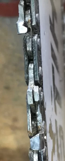

While sharpening my chain today I realized how much more worn the inside cutters are than the outside ones. I use the PFERD Chain Sharp, and have always used 2 strokes on all the cutters (after all it is a 2 stroke :) ). I sharpen them from the short side toward the long side, and always throw out good chips after sharpening. I think I'm doing it right, but maybe not.

So, this must be mechanical, and not procedural or something else like torque to one side causing uneven wear. The PFERD uses two files, one for each side, actually three files as the middle file files down the depth gauge at the same time. I've been using this sharpener for two years and have been very happy with it. I just changed the files about a month ago, I think the first thing I need to do is check the file that sharpens the outer cutters. It may need cleaning or rotating.

All the reading I have done, it appears that a lot folks take more off of one side than the other. It just depends on how you hold your saw/bar/chain when you sharpen.
Let me guess you're right handed?
Because of this it's more natural to put more pressure when sharpening the left side cutters, you probably don't even notice this, but because of the increased pressure you are removing more material with every stroke. The right side cutter are more akward when sharpening and you are applying less pressure removing less material.

I'm right handed, and this makes sense. I have noticed I tend to have more difficulty with the right side cutters, and trying to keep constant pressure side to side. I like your compensating with more strokes on the right side. I want to get the full life out of this blade, so I need to take more out on the right side anyway, and just enough on the left to help it through. Apparently that's the way I've been cutting with it lately and I thought it was doing great, but obviously not as well as it should have been.

I like the Stihl / Pferd sharpener a lot. Then I realized how different I was getting the tooth length from left to right teeth. The right always being much shorter - I'm right handed. We all hold tools differently though. I cut 16 cords over the last year, so I did a lot of sharpening. The files need to be replaced often, especially the raker file, or it does all kinds of goofy things to me; mostly uneven filing from side to side. Because of the "follower" design that rides along adjacent teeth, and my filing more on the right teeth due to pressure, I actually started to notice pulsing in my cuts.

I like the Stihl / Pferd sharpener a lot. Then I realized how different I was getting the tooth length from left to right teeth. The right always being much shorter - I'm right handed. I cut 16 cords over the last year, so I did a lot of sharpening. The files need to be replaced often, especially the raker file, or it does all kinds of goofy things to me; mostly uneven filing from side to side. Because of the "follower" design that rides along adjacent teeth, and my filing more on the right teeth due to pressure, I actually started to notice pulsing in my cuts.
