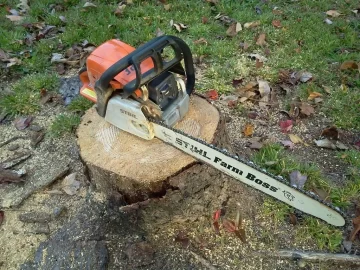

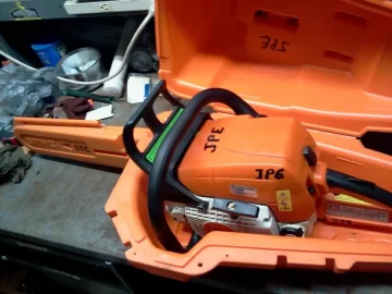

I picked up this MS290 a couple weeks ago for $200 and have already cut 4 cords of red and white oak with it. I bought a couple new chains. I'm liking the 20" bar & 56cc's. Starts very easy and does what it should.
