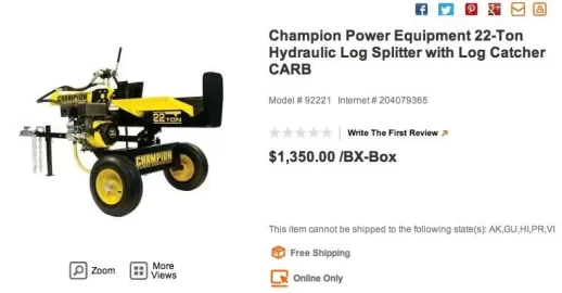

Hey guys,
Are these champion splitters any good? Looks good quality and well built, what's the skinny on them?
I'm still searching for a decent 20-30 ton h/v splitter, which has a nice large log catcher/ table. I hate having to bend over to pick up a split that needs split again, I want it to stay on the table. This Chapion looks to have a nice large log holder.
I wanted to stay at about $1k, but that just isn't hapnin.
http://www.homedepot.com/p/t/204079...-pricegrabber-_-D28X-_-204079365#.UdBjcsu9KSM
I'm not crazy about the way the ram is mounted on those splitters....I like the "I" beam to go to the very end of the ram....makes for a stronger splitter. A buddy of mine has one of these and he's already had to rebuild the ram because of stress at the seal.....

Agree with SO.
For that money, I think you can do better.
Check out the guys thread that just got his Husky 22, he seems really happy.....
Anywhere else Machria might be able to find a less $$ machine. But "on the island" he's limited to HD, Lowes, and the locals. Not a TSC (22 ton Huskee) within an hour of him. IIRC he doesn't want to have to assemble the thing, just pull the rope and go. Unfortunately for you, Machria, that means you will likely have to pay a bit more for it. The Champion units looked OK when I saw them up here, but I'd price compare against the Ariens and Troy-Bilt/MTD/CubCadet 27 ton units. The Troy-bilts and Ariens machines may be easier to get parts/service for down the road.

I am not a fan of trunnion mount cylinders for splitter applications. I know there are a bunch of them out there, but there are also a bunch of broken ones out there.
Reactions: ScotO
Is that what you would call the Champion "style" mount, a "trunnion mount"?

Well, the true trunnion mount is usually posts sticking from the side of the cylinder. I used the term "generically" to represent a front mounted cylinder.
