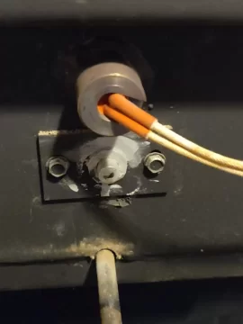

Okay I'm just getting around to doing this now. Is there anyone that can tell me how I get this igniter out from the front?
  • [Hearth.com] Changing the igniter on St. Croix Afton Bay
Did you not read post #2?
