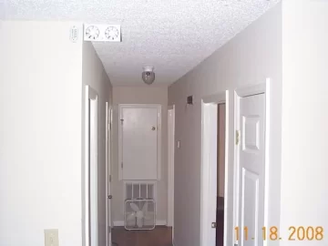

If anyone is as cheap as I am - here is a possiblity. Got my Resolute Acclaim up and running but still chilly in far corner of MBR. As I read here - I tried blowing air down the hall floor toward the great room (stove location) and having hot air return along the ceiling. Seemed to work pretty good. Problem was: VERY cold bare feet. So, I want to move hot air down the hallway toward 3 BRs. I tried a dual fan window unit suspended from the ceiling - worked but looked horrendous. Had a few 80mm computer case fans (also in computer PSUs) - rated at 32 CFM...so, I screwed 2 of these to a board, put in a switch, painted white with can of plastic paint and powered with an old AC-DC adapter (from some toy?) (12vdc, 0.3 amps output) - it powers 2 fans (0.11 amp draw each) fine. I installed a 120vac outlet in attic above fan board and just plugged adapter in. First time using it is today. Got stove at 500 degs. I can feel faint air movement 12 feet down the hallway - thermostat location - tstat shows 78 degs (40 degs outside). Will see how it does at 20 degs. I may add 2 more fans but need another power adapter. If I add more fans - I may just use an old AT/ATX PSU and power all of them - but that PSU would probably use much more energy than basically 2 cell phone chargers. An added plus - with TV or radio on - you can't hear fans.

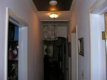

Here's my redneck solution. The fan is plugged into a cord that goes in the attic. It works well to spread the heat in my small 1150 sq. ft. house.

Agree with Brian...small undervolt is ok - will run a tad slower....overvolt is the no-no....overrevs, sounds too loud, will be burn windings out, minor fire hazard, too. Most computer case fans are 12vdc and draw 0.11 to 0.14 amps (110 to 140 milliamps)...check your transformer and don't OVER the amperage.

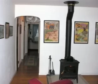

if I may add my idea here. Some of the pics i seen tells me some of you are living in a bungalow. you could simply cut a hole above the stove and run a 5 inch duct pipe above the ceiling down the all and then split it to the rooms you want. take a pipe and have a return come from the hall back to the room with the stove but carry it farther away so that the air will circulate evenly. The pipe is cheap at home depot. you will also want to put the insulation sock them so they maintain heat to where its wanted. once the ir is in the room it will need help to get back so a return line is needed.
The idea to keep the return away from the intake is so that that ir will warm up before its taken back to the room. www.princessauto.ca is a good site to get a 12 volt fan that sits in the ducts. you will need 2. Vents can be purchased to close up the face of the holes and will allow you to shut the heat flow to desired rooms.

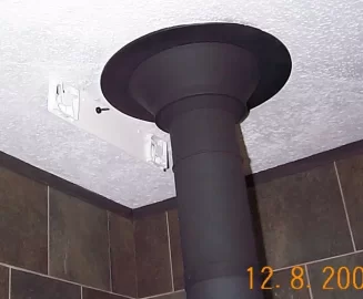

I made another dual fan to move air from around stove toward hallway. Want to see if it warms hallway more quickly.
