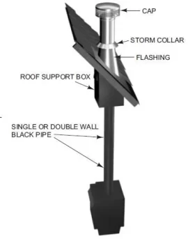

When you use a product for something other then it's intended purpose you take responsibility for the outcome. Black Pipe is not intended for use as a liner and it sounds to me like yours installed upside down. If your fireplace needs 6" pipe, you should run 6" single or double wall Black Pipe to an increaser at the roof support box and from there you can use your current 8" double wall insulated pipe (if it is 103HT listed). Your install should look similar to this (if I understand it correctly from the info you provided).

Sorry haven't checkeds this post for a couple days. What I have is an 8'' chimney pipe, I pulled back the plate around it and seems to be a silver color pipe with some insulation and a metal case around that I think it's some sort of chimney unit from the late 60's. Anyway what I did was to install 2 2' sections of single wall black 6 " which goes from the stove to the 8" hole-which seems to be the start of the chimney. And at the 8" hole I used the double wall black 6" -4 pcs of 2'. This configuration extends a few inchs beyond the original 8" top. So to recap it's a 6" liner for an 8" chimney. The book that came with my stove discouraged adapting up in size, It said to use 6" . It was my thinking that double wall through a chimney unit ,( which looks similar to the one in the picture above), would be safer and more likely to perform correctly. I only have 12' of pipe total from stove to cap. As far as the gunk on the outside of the pipe I do have the crimped end down and it's all the same brand. The problem was that the little screws that hold the insulated sections together didn't hold together during installation and the pipe had a small gap. They slid off the center pipe lining the chimney and held the joint open. So they didn't hold it on they held a little off instead. I don't have any death wishes ,but If this senerio is deemed foolish by you guys, is there anything besides tearing up my roof and installing a 6" chimney that would be safe. As far as wood burnt I have been using very dead- no bark left- standing elm, and deadfall black walnut.
OK, that is an odd install. If you need to line the existing chimney, you need to use an actual rated liner, not a smoke pipe substitute - smoke pipe won't hold up to the conditions.
First, you need to stop burning, as what you described does not sound safe, as mentioned by a few others above. Next, determine exactly what the previous chimney is, as it may or may not be suitable for relining with a proper sized liner. A suitable wood fired chimney would usually be 2" thick insulated stainless wall (8 " chimney would be 12" across), but in the early days of stainless chimneys, they used a 1 inch wall, which no longer meets code requirements. As well, if it is damaged, or doesn't have the required airspace gap around it, again, you have a code issue.
Glad you had the time to ask the question - hope you see the concern I have for the setup you describe.
