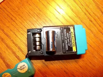

I have a handy tip for the owners of the Harbor Freight Cen-Tech Moisture Meter #67143. It uses 4 LR44 button cell batteries. They can be expensive to replace, even shopping a W-mart. I learned something and I don't know were I first read this, maybe it was here, but it's much cheaper to buy 2 A544 photo batteries than it it to buy 8 button batteries. It takes only seconds to peel off the covering of the Ray-o-vac Alkaline A544 to reveal the 4 LR44 inside.

I have one of those. I noticed yesterday that it is way off on moisture reading. It was saying that bone dry wood is 28%. My other MM says 15%. Batteries are weak. Ordered 40 Maxell LR44s, probably fake, on eBay for eight bucks shipping included.
I think that is exactly the deal I ordered, the batteries seem to work fine , I remove them when not in use and have not wore out a set in well over a year.
Yep, mine was accurate at first, then began to degrade. Replacing the batteries solved the problem. Removing one or more batteries between uses will extend battery life significantly.
