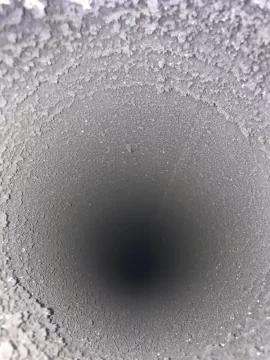

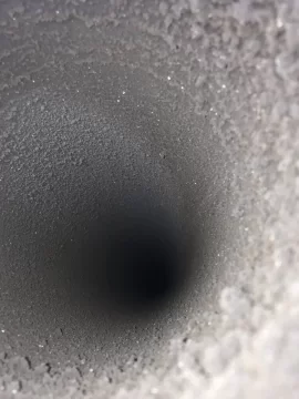

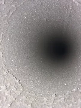

I didn't want to hijack someone else's thread so I started my own.
It's been a couple of months of burning in my new Drolet 1800 and this week I began longer overnight burns due to the colder temps.
Today I went up top and looked down my chimney to check creosote build up. It's fluffy and comes right off when I blow on it. The thicker stuff in the pics are right at the top edge about 2-3" of it and it blows right off also.
Almost a full cord and I think it looks pretty good so far.
Whatcha think ?

You’re doing great!
Check again in a month!
Looks perfectly fine. You could go more than a month but if the access to the roof is safe than why not
Reactions: oilcan1001
Access is pleasant with single story 6/12 pitch. I'm surprised I waited 2 months before checking, but first month I was only burning small loads in the evening.
