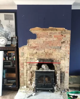

There is a metal lintel but it doesnt run as wide as i expected it to so am concerned if i open it up we might cause an issue. Have attached an image of the current situation and added in red a line where the metal lintel runs from to. I am thinking we may need a new longer lintel installed for the opening but am no expert so advice would be great. Being very cautious as with 2 younf children in the house really didnt want to make the front room dangerous in any way.

Your assumption about lack of heat is correct. A stove that radiates heat off the sides and back will put very little heat into the room, if surrounded by stone. I had the same situation (x2) in my house, you can see one of them in my avatar photo. I assume the stone surround you describe was once more than what you show in this photo, I can see what appears to be the remains of it.
For the replacement stove, if you will again have a surround or if you have a lot of exposed masonry in the room, should be a design with a high convective factor. OTOH, if you will stay without a masonry surround that there's no other masonry than that rear wall, any stove with a low rear clearance (meaning it doesn't put a lot of heat off the back) will do fine.
As to structural issues, you do have a bit of an issue, there. In a wall of sufficient width, when removing a lintel, you will typically lose a few courses of stone only in the middle of the span. It will form a natural arch, with the stones above holding in place due to the (equal and opposite, thanks to Newton's 2nd) horizontal forces applied by the surrounding wall. However, you have a narrow structure, so with the proposed opening being nearly as wide as the structure, there is some possibility the outward forces created by the naturally-forming arch could cause the side walls to buckle and fail.
Truthfully, if you hire a professional mason, I suspect they're likely to just pull the lintel and do the proposed work, without any secondary bracing. They're insured, and equipped with the knowledge and tools to rebuild the whole darn thing in the probably-unlikely event that there is a major failure during the short time the lintel is removed for replacement. But if I were doing it myself, I'd fashion some sort of temporary structure, likely just a vertical timber on each side of the fireplace, held together with a few bar clamps, to hold the sides from shifting outward during the lintel replacement.

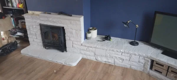

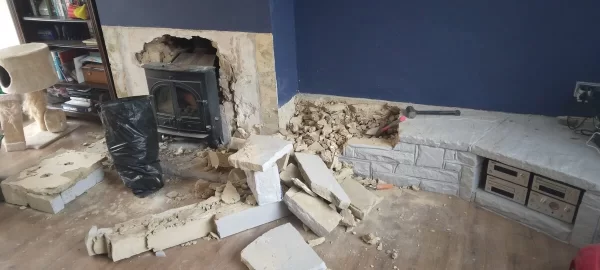

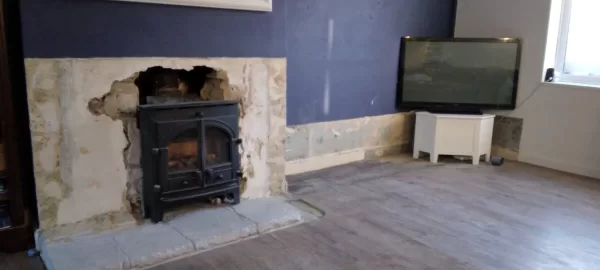

Attached a nice before, during, and after demolition of the stone fireplace surround and TV stand, man there was a lot of rubble in there! As well as the kind of thing we're hoping to achieve.
