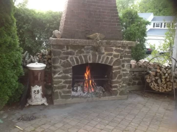

I have an outdoor fireplace, it does smoke out the front if you do not get a good a hard fire going, it all depends on what your burning and how your buning it. You need good dry wood, with a chiminea, I would think you would need to burn a lot of dry kindling continuously, but I don't know, I don't have one. So, it is normal for smoke to pour out the front, but not the entire time your burning, once you get hot coals and are burning wood at high heat, keep feeding it, all you will see is the rays of heat coming out, but you got to get to that point first....

Nice fireplace ram, but what a shame to see that Godin out there rusting.

Not a shame, it is inoperable, I have 3 choices, sell for parts, throw it out or keep it where I burn... So it will stay
