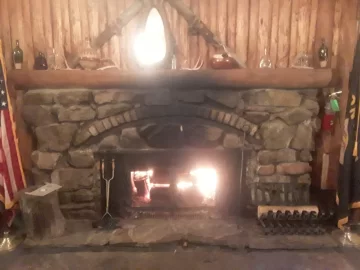

Hi all,
At work, I have been put in charge of a big fireplace remodel project- we are putting an Avalon Olympic insert in the fireplace of our 100 year old lodge. This involves A. pulling the horribly inefficient old metal "insert" that was put in the masonry fireplace ~40 years ago (it barely heats the room at all no matter how large of fire we get roaring in it, and it spills chit tons of smoke on start up), and B. doing something to the 18" diameter uninsulated metal chimney.
I am stuck on what do to for B. The chimney is ancient, and totally uninsulated, and hasn't been cleaned for years (decades? 😬) I have 2 main ideas:
option 1. use a liner. clean the chimney (is there any brush big enough to even clean it?) and then drop a 6" pre-insulated liner down it (since this chimney is so large and uninsulated would it be beneficial to add an external insulation blanket to the liner too, even though the liner is pre-insulated?).
option 2. tear down the entire metal chimney and replace with new 6" Class A chimney (probably from Selkirk's Supervent line). This might be a bit more expensive due to the need for multiple wall braces, roof supports, and possibly a couple elbows if needed.
Any advise or input would be greatly appreciated! 🙂

That old steel chim would be scrap imo. Guessing almost any new insert/stove and venting will out perform the existing setup. Supervent is still at a great price. I just recieved some yesterday that I ordered online and it had not changed price since my last order. PM if you want more info. on where I ordered. Some retailers have gone berserk on pricing the same product. Crazy.
Keep in mind any new stove will require very dry well seasoned fuel to perform. Anything less will have you/employees scratching your head in frustration.
Scrap the 18.
