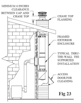

Download the Simpson Duravent installation manual as a guide. You are correct, straight up will work and look better. Perhaps this guy doesn't do carpentry. Just how is an eave structural? FWIW, I would not let him cut through the eaves. It sounds like he is telling you that he doesn't know how to do it.

Have your friend the contractor do the roof surgery and prep for the chimney chase. I'd also have him to the wall work for the thimble per spec and mount the thimble. Then it should be a straight forward process for the chimney installer.
Exactly!!! Have seen this diagram before!! I explained to him what I wanted to do and he wouldn't even think of it. I think I'll try some more numbers in the phone book.
