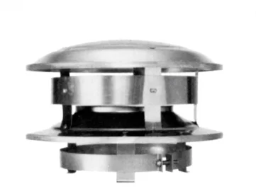

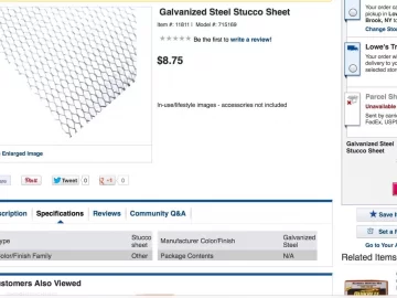

Woke up yesterday with two birds in my firebox I guess it's time to block the cap. Ran the cleaning brush up the pipe to make sure there was no nests forming. Is it ok for me to use galvanize diamond screening to keep the birds out. I have a four by eight sheet of galvanized stucco screen. I cut out of 5" x 30" and wrapped it around the outside and wired it together. Or do I have to buy a stainless steel band that they sell as you see with the pics below.

That stucco mesh will clog much faster than 1/2" or 3/4" screen.

What kind of chimney system/cap do you have? Many manufacturers make an optional screen for their caps. The Selkirk cap you pictured above has one available, but the band you mentioned is part of the cap, not an option that can be added and will not keep birds out.

I have a 20' Selkirk sure temp chimney, Also the Selkirk ht cap. I feel my draft is strong because every time I turn the air down all the way it burns pretty good. The flames burns my 3 to 4 pieces of 4 inch splits up in 2 hours. As for the wire I already put a piece around the cap. Let's see how long it holds up. If I have to change it every month I'll probably leave it off like you suggested until the spring good idea. The wire is nice and tight it's not going anywhere. How long it is going to take to get clogged is the real question. I might look for a bigger hole wire to see if it last longer if this does not work well.
