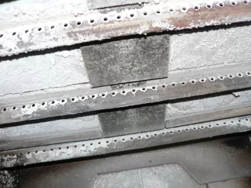

Thanks for the reply. I'm pretty sure the tubes will come out pretty easily but the firebricks at the top I'm really concerned about. I've never had them out. I can't tell from the diagram in the manual what is holding them in. Is this a bolt and bracket system or something else? I think this stove is from about 2002. Did Vermont Castings use a standard system for their firebricks in their stoves at that time?

Here is a pic of the inside of the stove. I've had the tubes out but the bricks don't seem to be sitting on top of the tubes. It seemed like there are some type of bracket holding the bricks. How are brackets held in place? I don't see any bolts. What is the trick that I'm missing?
Thanks,
CW

Don't think there's any trick involved. Remove the bricks and sweep down and clean out. Sorry dont remember a bracket in place, but thats better. You can use a paint brush, whatever you want to sweep out dust and ash inside the stove while you vacuum it out..
Thanks Stovelark, I will give this a try and see how it goes. I may replace some firebricks while I'm in there. This VC Madison has been a really good stove, we really like it. Thanks for the assistance. CW
