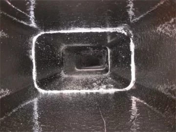

If by "shiny" he means like the pic below then don't be burning into that chimney until a professional gets a shot at it. It is a 911 call waiting to happen.

Thank you all. I showed the pic to hubby and asked him if that is what he meant and he said he wasn't sure it looked like that but it wasn't dust. He cleaned the chimney with the wire brush-on-a-rope and got a 5 gal BUCKET full of crap from inside the chimney. YIKES! I asked him how it looked and he said he thought it was better. Guess who it going back up on the roof to check for me again? If it is not better, I am not using the stove.

If its as shiny as the one BB showed us, it will have to be chemically treated, so expect to pay a bit more than $100. A homeowner with a chimney brush will never remove shiny creosote.
