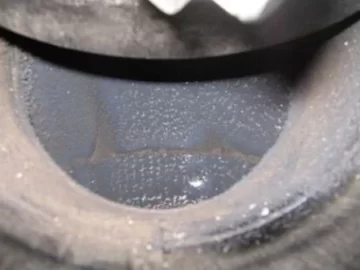

this is my first year with my wood boiler so i am trying to keep an eye on things, i would prefer not to have a chimney fire. i run a brush through my chimney about every two weeks or so to be safe. all i ever really see is basically a very dull dust inside the pipe. in fact i clean out the pipe from my boiler to the breeching pipe with a toilet bowl brush. i really dont let my boiler idle, just load it up and let it run flat out until it runs out of wood. is the dust i see a pre-cursor to creosote, or is this normal for regular burning? what are the first signs of creosote? i always hear of some liquidy type goo running out from pipe joints. i have none of that. help the rookie out. this is looking in through my baro.

I believe the dust shows that you are burning correctly. I think sweeping every two weeks is a little excessive. The manual for my furnace states that you should sweep when the creosote gets to be around 1/8" thick.
Creosote is black like tar and will burn like it. (Put that picture away before it offends someone it doesn't even look like you are burning wood-LOL). If I could get my chimney to look like that I could rent out my chimney brush but alas I must let my boiler idle. You are doing quite well! Maybe you should rent your brush out???

Believe me, you don't want to idle! My Eko 25 with inadequate storage has been a pleasure to operate during this cold weather but this morning after a 30* night and too much wood in the firebox, I have what appears to be another 1/4 inch of creosote in the firebox and since it is in my basement I have a foul odor throughout the house.
