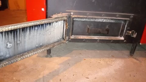

Here's mine right now...it usually runs black (dry/sooty, not wet creosote looking like yours) but is currently pretty light colored from running harder the last few weeks.
Interestingly, I checked my ash pan door frame bolts and about half of them were loose...I put about a quarter turn on most, a couple took closer to half...I did not put the "super torque" on them, they are after all only 1/4" bolts...plus the furnace is still a bit warm from this mornings smallish load, so if it was tightened too much now, they could be even tighter cold.
