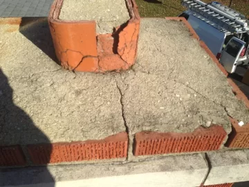

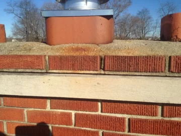

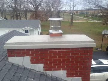

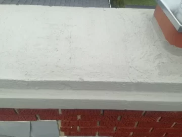

Here's some pictures of one I did back in the fall. It can be pretty bad and still be repairable. I used chimney saver crown coat.
You and i disagree on that. I have not had any last that long when the crown is that bad to start off. But to each their own if it works well for you great. What prep do you do?
Wow that turned out nice ! Mine isnt quite that bad, the terra cotta just has hairline cracks but crown is showing some cracks similar to your second picture. just out of curiousosity what would I repair like that cost ?
I wire brush the entire crown, remove the dust, caulk all the cracks and then do a thin coat. Once it's tacked up I do a second coat. Even if the repair doesn't last as long as advertised, replacing the entire crown isn't an option financially for most people. A lot of people don't mind doing periodic maintenance on their home, the chimney is no different.
If you do it yourself it can be done for less than $200.

Typically for crown coat we get $300 to $400. In my experience doing the same prep as webby sometimes with an acid wash we typically only get 3 to 5 years out of one which is why we don't do it much at all anymore. But a normal crown from us is $600 to $700 and should last 30+ years. Maybe I am not doing the crown coat right i don't know but to me it doesn't make sense. That is just my opinion i know lots of sweeps like the product I just don't.
