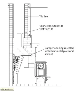

Here are two diagrams. The first is the original. The second shows minor changes I would like to make if these changes are allowed.
Please give me your comments on the second image:
1. Doing a hearthmount, I want to lower the damper blockoff plate. Is this okay?
2. Can I install a cleanout as shown in the second image?
3. Where the image says "liner": Does this mean the clay liner that already exists inside our chimney?
I guess I am a very visual person so I hope these diagrams correctly project what I am planning.

Yes on all 3 accounts Shari.
