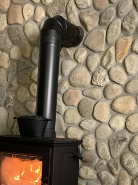

this is what the inside looks like

You have a nice setup inside.
It appears the horizontal run is sloping down into the wall. Maybe an optical...
If it can be made to slope up a little that would be better.
Betterer yet, go with two 45's. Less restriction, so I'm told.

The only reason I am suspicious of the thimble is because the rest of the chimney is very poorly done and I don't know what is under that stone veneer but as you can see the stone goes right up to the connection and they are stuck to something... so I have no idea whats in there.
also the current connection is horizontal and not angled at all even though it looks that way.

I went back and looked at pics from your previous post. The inside of the chimney does not look to be poorly constructed and it appears the thimble extends from the room into the chimney. The crack in the thimble could be a result of differential settlement between the house wall and the chimney. Or something else. Can't tell from limited info.
