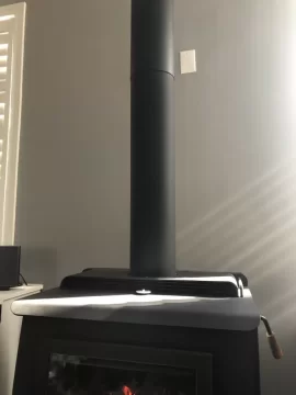

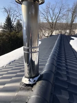

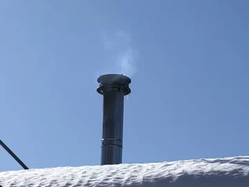

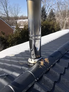

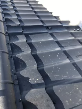

I'm dealing with a situation that's worrying me a lot and I'd appreciate any input that could shed some light. It's a long post.. sorry... First, I love the BK Princess for its long burn time and s low heat output, but from day one I noticed my chimney getting much dirtier than with my other stove now, or any other EPA stove I've had before.
On my Blaze King Princess, my chimney gets really dirty, especially the end-cap which is always full of big chunks of solids and also a lot of shiny creosote. I clean it regularly (2-3 times a season).
Some background:
- I have two stoves in my home, a Blaze King Princess and a Pacific Energy Summit. Both are free-standing. Both stoves were installed 3 years ago new.
- They are hooked up to a double-walled chimney, both inside and outside.
- I only burn fully seasoned wood, primarily ash and maple. I have a moisture meter and on fresh splits, everything I burn is under 17%
Comparing both stoves, I always have a lot more white/light grey smoke from my blaze king compared to my PE Summit. This occurs regardless of how hot the burn is going. From the Summit, I have zero smoke whatsoever; the only thing I see is the heat waves. On the PE I have no significant accumulation on either the Chimney or the end cap, no dripping, and no deposits on the roof. This is with burning the same wood and same burning practices.

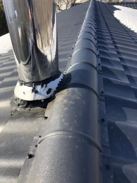

The biggest problem is that the Blaze King chimney is dripping. I never really noticed on my brown asphalt roof, but we had a black metal roof installed ($$$$$$$) 2 months ago and it's dripping brown stuff on it. First it looks awful, and second it will surely quickly damage the roofing material. If this has happened in 2 months, I can only imagine what it will look like in 10 years.
The cat physically looks fine and glows red. I always burn with the cat in the active zone, and to try to reduce the issue I have been running it hotter but the effects are the same.
I've checked the gaskets, both on the by-pass and the door using the dollar bill test. They re good.
What could possibly be going on here? Is my catalyst bad? Am I missing something? Do I need to get rid of my BK and put a non-cat burner???

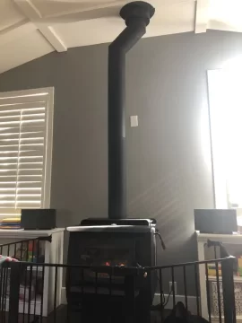

Is the same wood being burned in both stoves? Does the BK stove have a double-wall stove pipe connecting it to the chimney? How long is the connector?
Hi @begreen
I am burning the same wood in both stoves. For the past few months, it has all been seasoned ash and maple cut and split by myself and dried for 2.5 years.
Both stoves have the same chimney system - double wall stove pipe inside, connected to a double walled chimney system outside. Both have been WETT certified. The interior stove pipe is probably around 10 feet long, then a few feet through my attic, and about 4 feet above the root. Total chimney length is 16 feet. I have never had any type of draft issues.

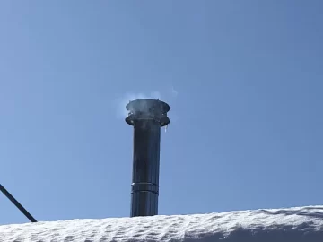

On a related note.. in the PE Summit chimney system, I have nothing but fluffy black stuff that comes right off. While on the BK princess the chimney is full of oily /chunky stuff.

That all sounds good. If you are burning 24/7 in the BK for 5-6 months/yr then it is possible the hours on the cat is >10,000K and at end of life. Performance will fall off and the cat needs to be replaced. The first replacement cat can be claimed on warranty.
I am burning more or less 24/7 for 5 months a year and I've had the stove for 3 years. It is probably approaching 10k hours.
I assumed that if the cat was staying in the active zone, it continued to perform.
For sure I can see that my system is not burning nearly as cleanly as I want or need.
Are there are points that should be considered? I've seen before other members mentioning that they icicles on their BK chimney end caps.
If you are noting a marked increase in creosote accumulation that is a sign that the cat is no longer burning efficiently. Did you have this problem a year ago or during the first season of use?
You could try removing it and pickling it. Highbeam has a posting on doing this for his Princess. That may get you through the winter, but once a cat is over 10K hrs. performance diminishes.

I do know one thing, cat or not, the deposits on your roof are condensing water vapor and soot (creosote) and if you don't address the issue, you are headed for a rocket ship flue fire. Least you have a metal roof and not shingles that will combust.:eek:

Alright, so with warm temperatures today I just went up on the roof and cleaned all the area with soap and warm water. Luckily my roof has a low pitch.
After an hour of scrubbing, I would say I cleaned up 75% of the stuff on stuff. I'll have to go back up with a bristle brush and stronger cleaner (possibly degreaser) after I check with the manufacturer.
I've contacted my local dealer about getting a replacement cat. In the meantime I won't be using the stove. Yay propane.
In hindsight, had I known about the expense of a cat, I might have gone with another non-cat burner.
Either way, here's what it looks like after my efforts.
