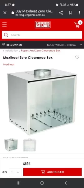

I know nothing about the codes in Australia but here generally insert installs in zero clearance fireplaces don't meet code. Do you have a liner running from the insert through the old fireplace flue
Pretty much all inserts can be bought with a zero clearance box as mentioned, so can be installed in a masonry chimney, or inside a stud enclosure using the optional box that looks like this.
