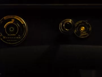

You can try putting a meter on the front of the box in different spots. On the Buck 91 I put it above the door, about where the top of the box hit the front. If you have an infrared thermometer, you can open the door and shoot the top of the box, and see how the actual temp relates to what you are seeing on the meter on the front of the stove.

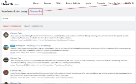

This website has a lot of good information and tips on wood burning. The 3d video on this page - Efficient Wood Stove Operation, has some helpful tips.
