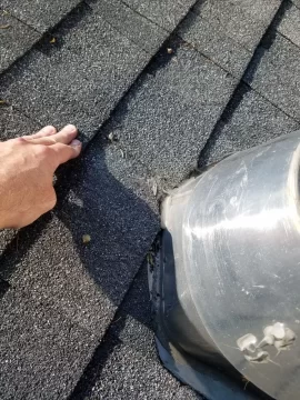

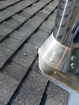

Where my hand is in the first pic is how far up the roof can be pressed. My best guess at this point is the flashing has just bubbled up from heating/cooling and with that, pushing the shingles up. Likely a non issue that my OCD wood burning self made into a bigger issue.

It looks like the roofer just didn’t cut that top shingle back far enough and it is riding up onto the cone. What you feel collapsing is just the shingle flexing down to the top of the flashing which is laying flat on the roof deck.
Either way, I expect a finger width of flat flashing exposed between the shingle and the cone so I would (or a roofer) be trimming that top shingle back. This allows water and debris to flow cleanly around the cone.
Does it spring back when you push on it? Where your fingers are just happens to be the top edge of the flashing. Like I said, when the flashing was nailed down it may have been cold. Then in the heat of summer the flashing hits 100 degrees in the sun. That makes it expand. When it expands and has a nail on each end, it will puff up in the middle. When it gets cooler it will lay flat. If this is the case there is nothing to worry about. This goes on everyday on every roof. I dont see anything to worry about.
