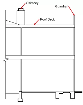

In my specific condition, the chimney is existing. The roof deck is part of a new addition, adjacent to the existing structure. There is no guardrail at the chimney side as the adjacent sloping roof does not create a safety risk of falling off the roof at that side. The existing chimney is only 4'-6" above the roof deck surface. (See attachment) So, the top of the chimney meets the 10/3/2 rule. However, it seems odd to have the chimney discharge so close to where people would be. A plan checker told me that it is left up to interpretation and cold be required to be raised to 8'-0" above the deck surface. That would trigger bracing and anchoring requirements that could be substantial. And, that is that ruling based on? I see no provision in the code that requires such an extension.
What is your opinion?

I did get an interpretation from the building department and they said the cap, ie any metal portion would need to be 7 feet above finished deck surface. So be it!
