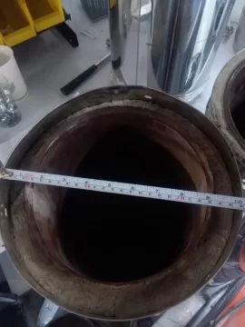

Hello all,
I am pretty sure that this is the right section for this question, and my appologies if I have posted this incorrectly. I have perused around the forums to see if this piping has been IDed yet, but no luck. Unfortunately this is stopping a job, and replacing it is looking to be too costly. Another stumbling block is that the seller owes money back to the buyer, and is no longer talking to anyone about anything.
This piping is on a brew kettle for a 15bbl brew system. I'm not sure what temperature is going through the pipes, but the burner is rated at 400,000 btu.
There are no lables/stamps/imprints or anything else, and I'm getting stumped on how to find the right support box for the roof penetration. If there is anything else I can describe or take pictures of to make things easier I would be more than happy to do so! Thank you so much for any time you can spare to this, I appreciate any and all feedback.

Looks like 10" ICC/EXCEL Class A Chimney Pipe to me. Your local EXCEL dealer will be able to get the support box you need, unless he has it in stock...
http://icc-chimney.com/en/excel
