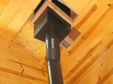

Different manf pipe wont mount up or seal properly. I used Simpson with a ceiling support box and it was no problem to frame. I had to jog the pipe with a couple elbows to get through the trusses but not really a big deal. beter to stay as straight as possible and inside then thru the wall. heres a pic

The interior setup will be much cheaper (use more single or double wall black versus more Class A for exterior) and will give you better draft. You could always offset the Class A above the ceiling using either 15º or 30º elbows. You can't mix/match pipe brands as it will void the UL Listing.
