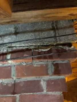

Thanks for your response, really appreciate it. By front side I just mean street side, and vent covers just means caps - sorry. I will attach a photo from the attic of the front/street right corner where it's leaking worst. Most of it looks like it's coming from that seam right below the concrete but it also seems to be dribbling in from other lone spots (see bottom left) as well as above that band of concrete. Plus it's leaking all along that side, (to the left of this photo) especially at the opposite corner. Flashing and new brick chimney have made no difference!

I don't think I will be able to help much more. I'm no chimney builder or expert, and that looks different than any chimneys I have seen. With the stepped bricks & concrete at the roof line. That's the new one?

What is that concrete portion just before the chimney enters the roof?

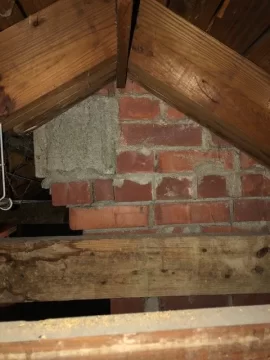

I've never seen cement block laid on top of brick like that for a chimney repair. But with that said I'm no mason either but those joints don't scream quality brick/block laying to me. That aside I think from the lone picture the leak looks like it's around the flashing. Or a crack in the block.

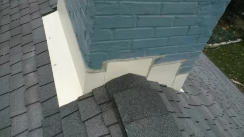

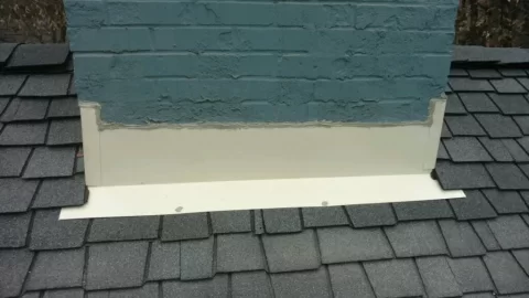

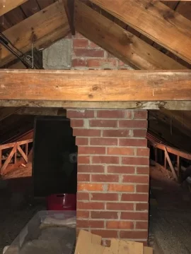

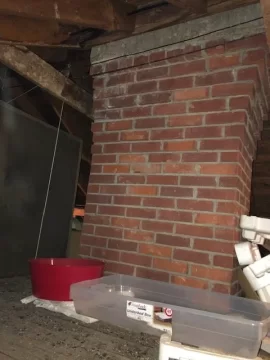

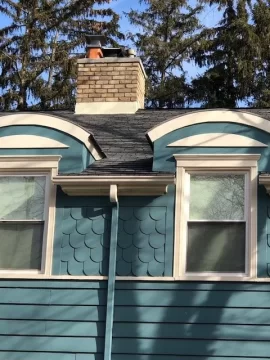

More pics... From inside the attic (you can see chimney is offset in kind of a strange fashion) and outside of the old brick with new flashing as well as new brick from a wider angle. Hopefully these help!

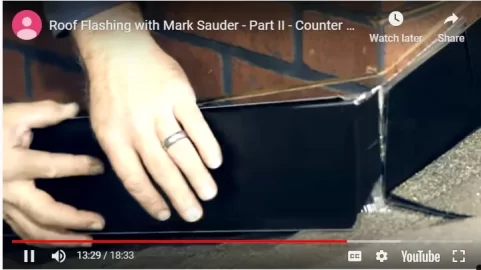

Check this video out.
It doesn't look like a kerf was cut into the brick, flashing inserted into the kerf, then caulked and sealed.
  • [Hearth.com] CHIMNEY LEAK NIGHTMARE...
Reactions: hickoryhoarder
Kerf ,reglet. :)
Reactions: Sawset
Yes, there's no counter-flashing.
Is it? What exactly is wrong with it, so I can have some ammo against the folks who charged me for it?
First you must have step flashing for each shingle course, then counter flashing over that and tucked into a mortar joint. That is continuous flashing like they did years ago with skylights and they always leaked.
