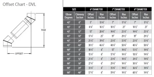

Thanks.. Until I rip out the ZC and get the alcove built I won't know for sure how the existing flue hole will line up with the outlet on the stove when in place with proper clearances. However, I'm thinking I'm going to need an offset of 3-4 inches. I found an offset chart at http://www.northlineexpress.com/elbow-offset-charts.html and it says I could use 2-15 degree bends with 9" pipe between to get 4". What is that "Rise Inches 24 1/8" value for? If I do the offset as close to the top of the alcove as possible should this be ok?
Here is the offset chart for DuraVent DVL pipe. Click to enlarge.
