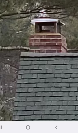

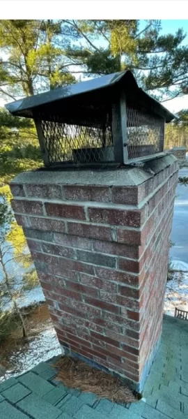

I am attaching a photo I took of the cap. Still waiting to hear back from sweep with his close up photos.
That is a good point on the cap and crown sealer!

Would you mind letting me know if you think the current caps are sufficient as that will save me $1k!

The cap certainly is sufficient but if the crown is bad it's possible replacing that cap with a full coverage skirted one may make sense economically

I'd have a new concrete crown poured or cover with a stainless steel skirt.
I've mesed with crown repair and it' s a short term bandaid.

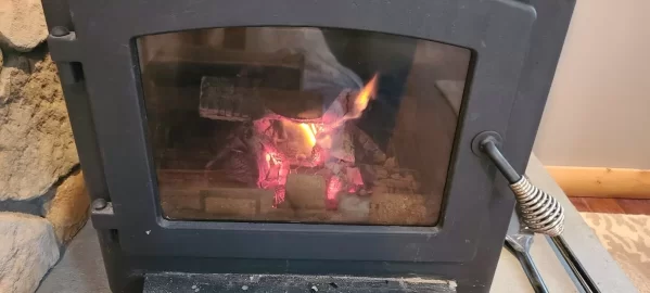

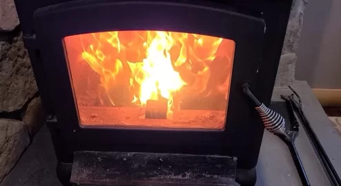

Before I spend that much money on my stove I want to run one scenario by you all. I purchased kiln dried wood (verified through seller and moisture meter reading on fresh cut splits under 20%) and ran it in my stove. I am attaching two photos. One is a photo of the stove with the door open. Had it open for about 15 minutes and the stove top temp read 750. All air is open at this point. Second photo is about 30 seconds after I closed the door, air all open.

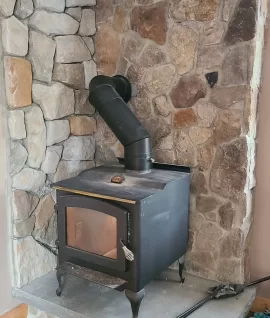

Is it normal for the flames to drop that much? I understand it isn't getting the same amount of oxygen, but I want to make sure a new steel liner will fix this as I can't afford to waste that kind of money. Also including a photo of the stove type showing the pipes. Thanks!
