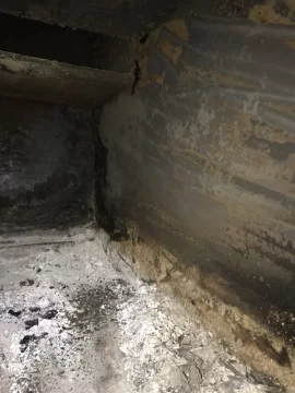

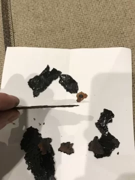

Hi. I am hoping to get opinions based on those with more wood burning experience than me. Some background, this is our first winter in a new to us house built in 1980. We have a vented fireplace on the main living floor and an older non-epa wood stove in the basement. In June 2021, we had a local chimney sweep company come out to do an inspection of both flues and to perform cleaning if needed. They ended up cleaning the fireplace flue but said the wood burner did not need cleaned at the time. The prior owners stated that they didn’t use the wood burner during their time in the house (13 years) but had no insight into what the owners before them may have done. Through the summer I read up quite a bit on the effects of burning green wood and have been doing my best to avoid that by burning only standing dead trees that I also moisture tested. We have been having a mild winter and to date I have probably burned 1/3 cord or so. I burn primarily in the evening for 4 or 5 hours before going to bed, so this isn’t a 24/7 thing for me. Anyway, I climbed up on the roof today to see what potential creosote buildup was looking like. When I removed the chimney cap for the wood burner, I was greeted by a glassy layer of creosote running the length of the clay tiles (20+ feet from the bottom of the flue to the cap). This layer was very thin and not particularly tarry to the feel but I was surprised to see it since all I have been getting in the stove itself when cleaning it is soot and ash. Now I’m nervous to burn since I obviously don’t want a chimney fire but I have no idea how my burning technique could have cause such a layer so quickly. Unless of course the chimney sweep just didn’t want to deal with it in the summer heat. I could set up a cleaning again but chimney sweeps are busy in winter and I don’t think they’ll be able to get to me for a month or more. Does anyone have any advice or am I reading too much into it? 1 pic is the inside of the burner and the other are some chunks I pulled off the liner.

Low and slow burns in a cold exterior chimney can build up creosote quickly, particularly with many cold startups.
What stove is this with? What is the ID of the chimney flue that the stove is connected to?
You’ll have to forgive me since I don’t know much about my setup. I haven’t seen any kind of identification number or name on either the stove or piping into the wall. The main flue looks to be standard rectangular tile though. For all I know the stove was handmade, it would definitely fall into the smoke dragon realm however.
I can see continual cold startups causing creosote issues as you mentioned. And there may have been times I choked down the fire too much in an attempt to get longer burns (been playing with both the air intake openings as well as the pipe damper since the size of this thing allows it to just eat wood like crazy). But I’m still surprised that I would be getting these results after not even a half cord.

That is definitely a home made stove or one made at a local shop. It looks like it has 6" pipe on a stove which looks like 8 would be more appropriate. It then goes into a much larger clay liner where the gasses expand causing them to cool rapidly. That ammout of buildup is not at all uncommon for old primitive stoves like that. Especially going into an oversized uninsulated liner
