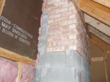

Snide remark - if it meets 2" clearance, how is it attached to the house?? ;)
Seriously though, The 2" is measured from the outside of the brick chimney, and I'm not sure how they actually build a brick flue that has 2" combustables clearance in a wood framed house.

Well I did lie, looking at the pictures refreshed my memory, I forgot I had some on my work pc. It is only connected to the house where the roof ties into in, it has a clearance to the walls. Attached a picture to help explain, I also understand what you mean, at some point my brick wall in my family room will touch a combustible surface even if it's 2' away from the chimney.
