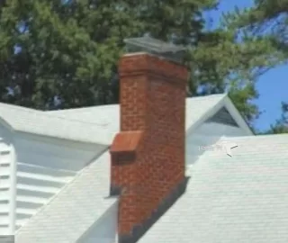

I understand the details about building a block off plate, and insulating it with roxul. My questions concern the top of the chimney. My chimney has two flues, one of which is used by a high mass natural gas boiler in the garage. There is one large rain cap covering both flues. Here is a picture from bing maps, as it's too dark to take a photo at the moment:

Can I just terminate my flexible liner into a top plate and reinstall the large common rain cap? I assume the top plates include a hose clamp or some other means of holding the flexible liner? Being that I'm planning to reuse the existing rain cap, I figured on just getting a flat top plate and attaching it with silicone to the flue since I'm not certain of the flue tile size:
[Hearth.com] Chimney Liner Installation Details
Should I just cut the top of the liner flush with the collar or leave it proud a few inches?
Being that there are two flues: Will I likely encounter smoke traveling back down the gas boiler flue? The boiler does have a motorized damper, but it will run when the stove is in use because it also produces DHW.
And finally: Can anyone recommend a supplier for a preinsulated stainless flexible liner for a good price?
Yes that is fine
Yes cut it flush
It can happen but will not when the boiler is running for sure. And while it can happen it is not that common. If it turns out to be an issue you will have to extend one of them but I would not do that without knowing if there is an issue.
