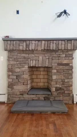

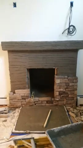

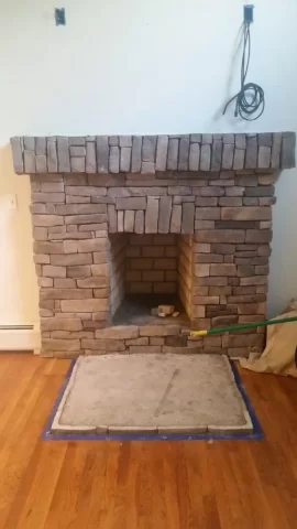

There is no alcove bumpout. The factory fireplace was removed and the fireplace has been reconstructed with stone, firebrick, and a new hearth for the Progress Hybrid. The new stove will sit on the hearth and rear vent to a 6" liner. I just read somewhere that a liner needed to be insulated within a factory chimney pipe. I'm hoping that isn't necessary.

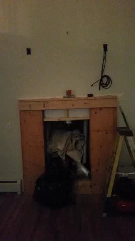

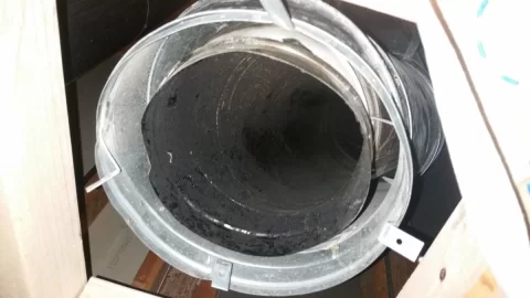

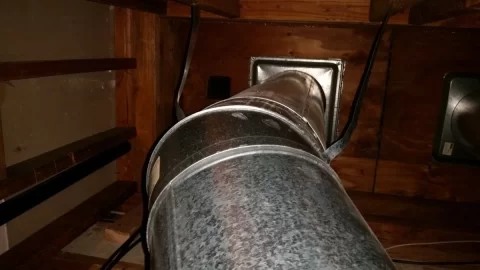

What is the chimney pipe? Is it the old Majestic chimney or is this with new chimney pipe that is class A? How is the chimney pipe supported?
Edit: Pics just posted show the pipe. This is completely wrong. It is air cooled pipe. It must be replaced with class A pipe and clearances to combustibles properly honored.
Edit. Pics just posted show the pipe. This is completely wrong. It is air cooled pipe. It must be replaced with class A pipe and clearances to combustibles properly honored.

Nope you are right it should be replaced. I am also concerned about clearances from the pipe to the wood behind that stone. Double wall might make it but it looks tight.

No you need new chimney pipe not just a liner.

No that chimney is not designed to be a standalone chimney it is only meant to be sitting on top of a fireplace. There is no approved way to support it as is while allowing proper air circulation for cooling.
Yes, this was built without full knowledge of clearance and chimney requirements.

I'm wondering if a supported class A chimney could end in a cleanout tee in this space with a double-wall stove pipe coming off the snout to the stove?

Since most of that opening will be obscured by the stove, can the OP use an ornate cast support for the T?

That would probably work. If need be a short section of class a could be added to the tee also.
