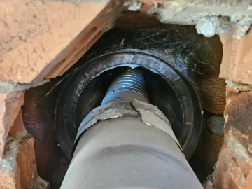

Well progress has been made, new pad finished with flagstone. BUT, facing what appears to be yet another challenge. Have discovered it appears a 5" liner was used in the exterior brick chimney (uninsulated), not 6". Discussed replacing this with a 6" insulated liner but installer says that won't fit due to the 8" round metal thimble that runs horizontally through the wall, only a 6" uninsulated will fit without major rework of busting out that thimble (don't really want to do that... not sure it's even feasible due to log construction)
Are there any other options to consider here for maybe partial insulation, or do I just accept 6" single wall? Cost is becoming a factor here... but cutting down on backpuffing and creosote is in my mind...
Here's a pic of the situation - 6" stove pipe running through brick ventilated wall, connecting to 5" uninsulated liner inside 8" thimble:

Could you run 6” uninsulated through the horizontal run and insulated the rest of the way up?
The thimble clearance requirements needs to be verified. Has the thimble product brand been identified? It appears to be touching wood or close to it. Some, like Safe-T-Thimble require 2" clearance as does class A chimney.
Has the thimble ID been verified as 8"? If so, then a 1/2" insulation blanket on a 6" snout should clear.
Thanks both, I'll ask about doing a partial insulated if all else fails. No, the thimble product wasn't identified - not sure how one would do that (experience?) as no identifying marks are visible. It may date back to early 80's? same date as the old Dutchwest stove that was removed. There is 2"+ air gap around the thimble - not touching logs. Couldn't get exact ID this morning without unscrewing that last piece of stovepipe, but it's got to be close to 8". I may need a second opinion on the 6" insulated, sounds like.

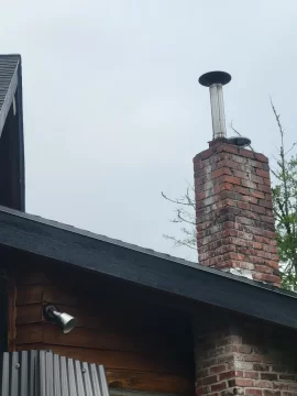

the ongoing saga continues. Cannot run anything bigger than the existing 5" liner down the chimney without busting out the flue tiles, which we were considering doing. However, the thimble has no UL label and therefore is not considered to current code and would have to be replaced. Additionally, the brick chimney + extension is not tall enough per current code.
Given all that, we decided to punt to going direct with pipe through the roof. Will still need an offset inside to clear some ceiling support. But the bad part is, the exterior part of the chimney will need to be about 14' tall due to a 2nd story roofline being too close, and braced off the fascia. I'm pretty sure this will not be a good look :( Here is a photo of that situation - the new pipe will be coming out of the roof near the existing brick chimney.
Any other alternatives that should be considered?

Agreed that a 14' metal chimney is not going to look good at all. Is there any possibility of locating the stove and flue in the main, 2 story part of the house? Chimneys in one story house extensions can be a problem at times, especially when the wind is blowing against the single-story side of the house.
Unfortunately, no - 2nd story is pretty small. Plus inside there is that special ventilated wall, and we just had the hearth redone in flagstone... If we do go ahead and do this, I'd want the exterior chimney in black. We've been discussing painting it with the installer. Just don't feel good about this though, as that is the front of the house too. ugh. Plus I'm sure that tall would make it hard for a sweep to clean.
The only other option I can come up with, is to try to return the stove (not delivered) and abandon the project.... which would totally suck. Or maybe put in a pellet stove which I think could use that old short chimney.
ok, good to know - although there would have to be an offset inside to get around some structural, two 45's - I assume that would make bottom-up cleaning more difficult.
Also have a safety concern about an exterior chimney that tall, we get some ferocious wind out here, has ripped off stuff secured by 3" deck screws...
45s are not an issue, rotary cleaners have flexible rods that have no problem going thru a 45. I have no problem putting mine thru a 90. The chimney would need bracing 5 feet above the roof line.
Sounds similar to those dryer vent cleaners I've used, thanks. Yes, the 14'+ chimney would need to be braced off the 2nd story fascia per 2 different installers.
Well, I pulled the plug on the whole thing - dealer and installer were super nice about it. Not sure what we're going to do now, but at least we won't have the mother ship smokestack protruding from the roof.
