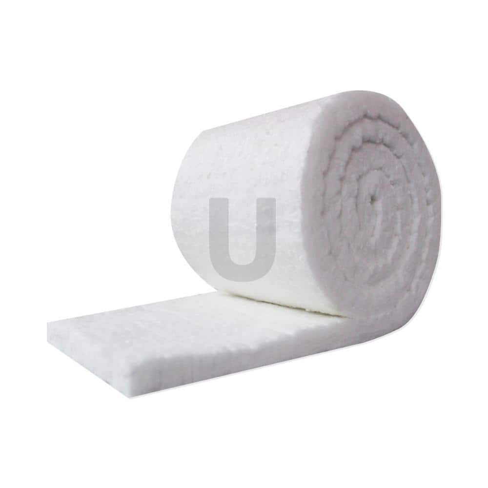

Also wanted to ask, would something like this be suitable for insulating the liner? Seems to be rated for the correct temps in the Drolet liner manual and is the correct thickness/density.
Then glue/wrap in foil tape and chicken wire?

Just get a listed insulation kit so you have a ul listed system
Ok, was just curious if that product would technically be in code, or if the lack of UL listing would disqualify it. Seemed pretty darn cheap for 50' if it would work and pass inspection.

It will not meet code no.
