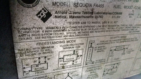

Right now the opening is 7x11 and is going to be about 25' flue length, I also found this tag on the back of the wood burner which makes me lean to a 6" liner versus going bigger
Here's a picture of the tag.

It says 6" so go with 6"
