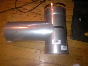

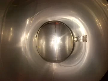

I just received my liner kit today and started piecing the T together. I noticed the connection is not flush. There are visible gaps when I connect the snout to the T and tighten it as tight as it can go. The gaps are not huge but definatley large enough for air/gasses to escape. I can easily see light through from the other side in several spots.
My question is should the snout connection be completely flush?
If this is normal, can I fill in the gaps with high temp caulk, stove cement?
If I can fill it in, wont it just crack and fall out from the hight temps?
Thanks

If you have good draft, you will never get flue gases/smoke coming out through those gaps...air will be drawn in. If it bugs you, you can try filling the gaps with furnace cement. Maybe around the outside too. Rick
Thanks Rick,
I am dropping this 6" liner inside my current existing insulated 8" liner. It is 25' so I suspect it will draft well. I guess Ill throw some cement in for kicks.
I'd think it would work just fine.
Now I wish the new liner which I am about to install did not include a T with a strap. My Chimney guy said he has seen the welded snouts break, so he recommended the strap style. I had not considered the gap issue.
My guess is Furnace cement would probably hold up for a few years before vibration and heat/cool cycles work it loose. I have very good long term luck with furnace cement where the stove collar and short horizontal pipe meet.
If there were any fundamental problem inherent to the operation of a flue system installation that includes a two-piece clamped T...they wouldn't be on the market. Rick
Mine had a slight gap, I used some furnace cement and haven't had any issues.

Chimney liner depot has been great. Very good customer service. They say it is not unusual and will send me some high temp caulk or cement just to put my mind at ease.
