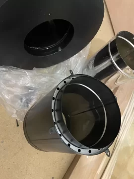

I finally got all the parts (hopefully) I need to install a glue liner in a masonry chimney. I went with DVL stove pipe and Duraflex liner. Since I’m going through a combustible wall to the chimney I purchased an insulated wall pass through: https://www.northlineexpress.com/6-duraliner-wall-pass-through-6dlr-wpt-6052.html . I also purchased the duraflex tee with cap: https://www.northlineexpress.com/6-duraflexss-tee-with-cap-6dfs-t-6573.html to connect to this. It does state that it connects to duraliner tee but not duraflex. Did I get the wrong part or can I simply crimp the tee and have a safe setup? Also, in the wall pass through should I do something to seal the gap inside (pictured)? I could not find anything through my research or through the duravent installation manuals for this setup. Thanks in advance!

I finally got all the parts (hopefully) I need to install a glue liner in a masonry chimney. I went with DVL stove pipe and Duraflex liner. Since I’m going through a combustible wall to the chimney I purchased an insulated wall pass through: https://www.northlineexpress.com/6-duraliner-wall-pass-through-6dlr-wpt-6052.html . I also purchased the duraflex tee with cap: https://www.northlineexpress.com/6-duraflexss-tee-with-cap-6dfs-t-6573.html to connect to this. It does state that it connects to duraliner tee but not duraflex. Did I get the wrong part or can I simply crimp the tee and have a safe setup? Also, in the wall pass through should I do something to seal the gap inside (pictured)? I could not find anything through my research or through the duravent installation manuals for this setup. Thanks in advance! View attachment 320386 View attachment 320387 View attachment 320388 View attachment 320389
Yes you got the wrong part
So which part do I need. the duraliner tee? If that is the case, will flex liner connect directly to it? Because it states that it is for duraliner products.
You need a different insulated thimble. Just one for a standard liner
The DuraLiner pass through is specific to the DuraLiner system.
Something like this is required.
