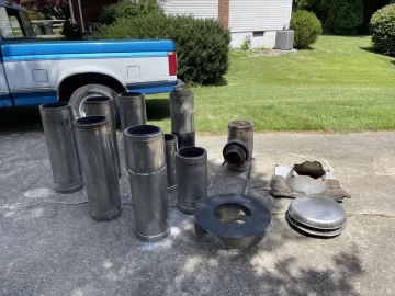

hello everyone , new member and wooden burner here. I’ve been reading a lot on this site for the past few months and finally decided to pull the trigger and ordered a Blaze King 40. I picked up this 8” stove pipe off marketplace for cheap but I need to buy a few fittings to make it work for my application. All of the stickers are missing does anyone recognize what brand this is to buy some more parts? Thanks in advance
BKVP
@webby360? Not DuraVent or ICC. Selkirk? Interesting metal tabs...

It is buckled, that’s is one of the pieces I need to replace, but the king 40 has a vent straight out of the top so I would need a different fitting instead of a clean out t anyway right?

The cap resembles Security SecureTemp chimney, but the wall pass-through is not like the current version. Verify the age of this pipe and whether it is up to UL-103HT standards. If not, it might be an older 1700º chimney that is not usable on a modern stove.

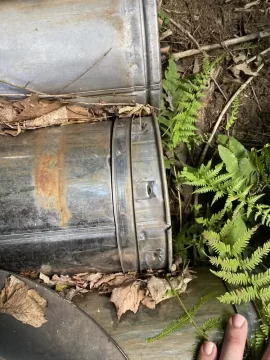

It looks similar to some older Selkirk I have. Before they changed the way it locks together.
I have mine in a pile out back. I’ll go glance at it.
Edit: This is my Selkirk. It has the lock tabs and a band/ring that slides down over them. Mine is 6” pipe, so it doesn’t look exactly like the OP’s, but I think that’s what his is.
DonTee
Dec 1, 2021
695
Upstate NY
My Selkirk pipe is old and they don’t sell the parts for it anymore. At least new they don’t.
Selkirk switched over to a different locking system at some point. I looked for parts for mine about ten years ago and the place that sells Selkirk parts locally only had the newer style. Maybe someone has some NOS parts sitting on a shelf somewhere.
I’m saving my stuff for a barn, or possibly a sugar shack some day. I’m not sure you could legally install that pipe anymore. I think it’s rated for a lower temp like Begreen mentioned.
