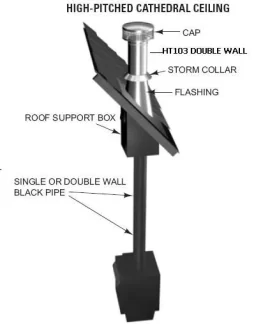

It is required that you use 103HT double wall insulated pipe above the ceiling. Here is a picture of what your setup should look like.
  • [Hearth.com] chimney pipe thru roof-does it need to be double-wall above roof?
