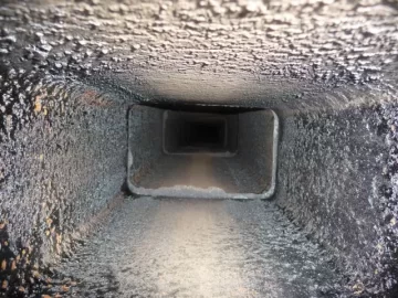

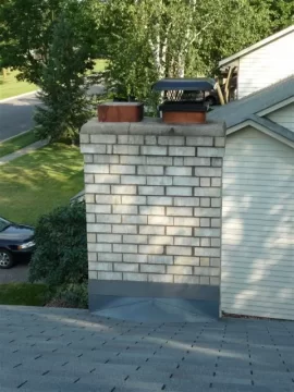

I'm getting ready to purchase my first wood insert this month, so I figured I'd go up and give the chimney a good sweep to clean it up for a new liner. When I started to sweep down the chimney I could see the a section of the clay liner wobbeling side to side as I swept. I'm guessing that this should not be happening, the section above it has no movement, nor the section below it from what I could see. The section is above the roof-line and incased in brick. Any Ideas what what to do??? thanks
had to run back up, so I figured I take a few pics

I would run insulated oval liner.If one tile is loose that means the refractory cement has fallen out at the joints.Other tiles are more then likely that other tiles are obout ready to go also.
the chimney is only 6 1/2 in wide, can you get a liner with insulation the thin?
A liner is the safe way to go. If creosote builds up in the cracks it could ignite.

The only way to go in my opinion is to get somebody in there to break those tiles out and then install an insulated or poured in place liner. I know I sure won't put a liner in one of my chimneys when the clay tiles could fall apart and take it with them.
duraliner rigid oval liner. pre-insulated. done.
