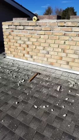

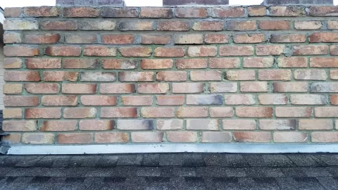

I've decided to install a wood insert for backup heat, have natural gas furnace. My masonry chimney hadn't been maintained prior to me buying the house and needs a few rows of bricks replaced along with a new crown at the cost of 12-1300. Problem is the weather has already turned and I'm worried about the concrete curing properly. Is there any reason I couldn't remove the 2 rows of bricks and then fab up and install a stainless chase cover and seal it? Would cut amd remove clay liner flush as I'll be installing a stainless liner and extending the liner with grade a 18-30"

Keep in mind that if you pick a day when the temps get into the 40's or 50's you could probably pour the crown. The chimney is in the sun most of the day so that would give you a good 6 hours or so of sunlight to warm and set the concrete. Cover with plastic, you could even put a moving blanket on top to retain heat but I doubt that would do much. I see plenty of builders pour concrete for homes, offices and structures year round. This is not a structural item and it should be fine in a week of sun and wind imo.
Just keep from freezing for 24-48 hours.
