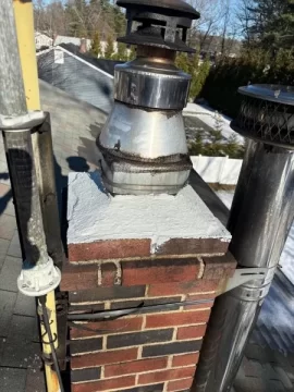

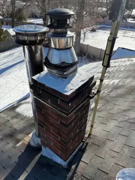

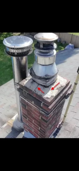

Hello
This is a single flue 8”x8” block chimney with brick only on the outside top roof portion. It has a clay flue liner and a Selkerk Masonry Conversion Kit with a Stainless Steel liner going down to a P61 in the basement. The new stainless steel Buderus boiler flue is right behind it. It has a concrete crown with a few of cracks. Little if any water gets in but coming into winter sealing it up maybe a good idea?
Has anyone else done this?
I used Saver Systems Crown Coat - 15 year warranty!
Real easy to brush on in very cold weather.

The crown looks to be in rough shape. If so, this may just be a bandaid. Is there an expansion gap surrounding the flue tile?
Thanks for your comments BG. The chimney which is cinder block on the inside of the house with a clay liner was built in 1962 so it is 64 years young! I do not know of any expansion gap but it has never leaked over all these years. Therefore I did this as a preventative measure before last winter from what you can see with my new DJI NEO drone before sealing it with the special crown coating.
It also did not leak this past winter after the crown coating.
Great idea using your drone for this!
