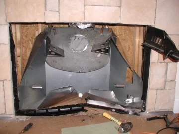

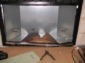

Well I got my Heatilator out. I actually took it out the front without destroying the stone or cutting it out from the back. Not caring about the fireplace I hacked though the metal with a combination of tin snips and a hand grinder.

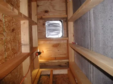

[Hearth.com] Chimney rip out? Not an easy job but doable. Notice the fire stop that I must overcome to get to the top. (That's looking up) I have all the inside stainless steel flue down and have a few pieces of the outside shell to go. I had to bend (or cut) most of the pipe out as it was 4 feet in length and would not fit though the fireplace opening.
Now I'm thinking about ways to brace up the "Wall Support and Tee" to the chase. I plan to put on a new S.S. chase top but still would like to put it centered to the original chimney opening just to keep the Class A off the side of the chase. I also want to use maybe metal unistrut or similar bolted to the wood framing instead of using just 2x4 framing. Here is the kit I plan on using.http://www.lowes.com/pd_208969-85178-JSC6WSK_0__?productId=3132365&Ntt=supervent&pl=1&currentURL=?Ntt=supervent&facetInfo= Thoughts? Advice apresheated.

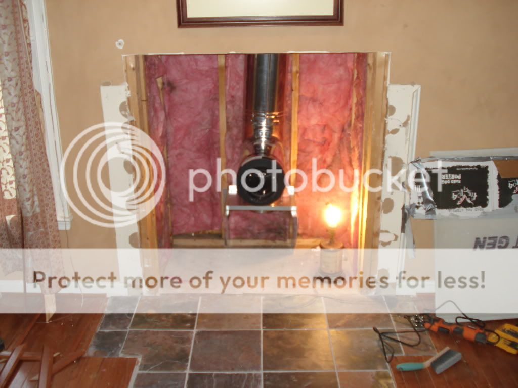

Looking good..... I ended up installing the support/base bracket to the opposite wall in the chase.
Might be a good idea in your application as well.

I was able to use the existing studs in the chase. If needed, I suppose you could cut some wood blocking (maybe 3/4" ply?) to secure to the studs so you can place your support where you need it.
I did have to use offsets to match the chimney run to what was there before. There was a grid in the install manual that went through the various offset options and what lengths/elbows would be needed.
No new top plate on the chase. The storm collar was wide enough to cover the existing opening.
22' run. I installed the top support first and assembled/lifted each 4' section standing inside the chase. Once the chimney reached the top my helper locked down the top.
I ended up cutting a 18"/18" opening in the bottom of the chase. Here is a pic:
