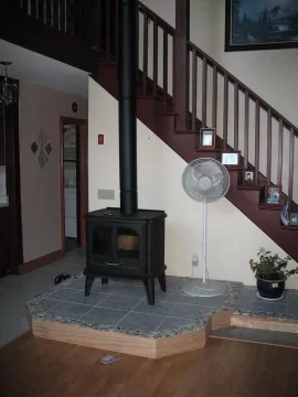

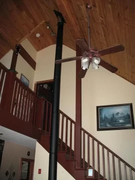

Yep. All insulated double wall black inside the house, triple wall silver through the ceiling and outside. I've attached a couple pics...its about 22 feet off the floor where it pierces the roof, another 4-5 vertical feet to get through the roof (11/12 pitch) and then 8 more feet or so outside.
So just a tube of stove cement to seal it up? I assume I have to pull the sections apart to get a good seal and probably have to remove the chimney and then take the collar out of the stove to do it properly, right?

As far as the pipe I wonder if it got twisted all the way? Mine runs up the outside of the house but it looks like the day I put it up.
The seams on the pipe line up within a half inch or so between any two pipes all the way up.
Any stove cement do or is there a difference in quality between brands?
Half and inch is alot, I would think they should all line up. May be best to have the installer take a look.
I know my pipe (Selkirk) twists and locks. Can you give any of them a twist?
I used Rutland and its been fine, came in a little tub though.
What the heck brand of pipe is that? Doesn't look like its mated together all the way.
We use simpson DVL double wall black and it would be impossible for anything to get form the inner wall to outside the pipe if it was connected properly.
I have double wall interior pipe that looks similar to that pipe, but I have small slots on the bottom of each section, that allows air to cool the pipe. For the life of me I can't figure out how you get ash on the outside of the pipe. I would think it's impossible to do on mine. Mine twist together also, hence the circular horizontal line on each section.
