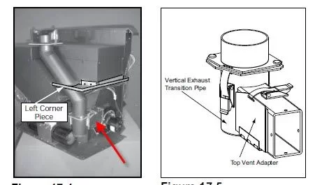

Again, thanks for the replies. Sounds like I better clean that area, I'll have to read on the leaf blower trick. I'll start there, then see if I can work up the nerve to get up on the roof with one of those round brushes this summer. I found these pics in my owners manual. Mralias, looks like the cover plate is on the left side, thanks for the info. I'm kind of anxious and scared to see what comes out. I think this might be the 3rd winter since I paid for cleaning and have just been keeping the front end clean, never cleaned anything more than this on it. So reading my manual it says to use a quality service technician to clean both the Exhaust Blower and Convection Blower, you ever tackle those by your self. Not sure what cleaning would entail, maybe pulling the motors and blowing them out and cleaning the blades maybe. My maintenance chart says these should be cleaned/inspected yearly. I don't recall the cleaning guy taking out the motors, maybe just blow on them with compressed air in place. I can see that not making the wife happy with white carpet in the living room. If nothing else, glad to know about that cleanout area, Thanks!
Yep, do it myself every year. Pull the stove out to work on it. The combustion blower requires a new gasket which you can make yourself fairly easy. I think Don 2222 made a couple of step by step instructions to cut out your own that are pretty good. Remove the 5 or 6 screws around the outside of the housing plate, unplug the two connector spades and it will pull right out. Ash is what leads to the demise of these units. The convection blower comes out easy and is located in the back center, just a couple bolts and it pulls right out. Unplug the molex connector and the area of cleaning is fairly evident. Lot's of ash collects on the bird cages. Also a cleaning of the vacuum switch line should be done a couple times a year. Unplug from the vacuum switch and blow or suck (never into the switch) and you will find a bunch of fines come out. Oh yeah, UNPLUG THE STOVE BEFORE YOU DO ANY OF THIS! Nothing worse than a fried control board. I find one of these shown below helps you move the stove around pretty easy. Slid it forward onto this and wheel it were you can work on it. Harbor Freight has the for about $12.

Wish the blowers on the cb1200i would not get dirty but the ash gets sucked right through the combustion fan and the cage on the convection fan gets pretty caked with a fine powder ash. I have had to replace both blowers in less then 10 years because of this.
Thanks for all that great info. I'll put it to good use, hopefully someone else will too. Have you had to replace your burnpot or flap plate yet? I'm on my second plate and now the pot has a patch welded in it. I found a hi-temp (Lytherm) insulator for the base of the burnpot, I'll have to search on the gasket making, guessing the blower gaskets don't need the super hi temp rating of the burnpot gasket.
