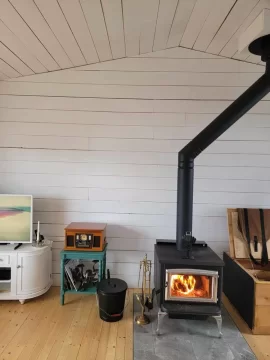

I'm getting a guy to come clean the chimney because of the problems I've been having. The funnels coming out of the stove has some 45s, are they gonna have to take them apart to clean everything or can they do it from the roof?

Some pictures would help
I would clean up through that with a rotary cleaner
So it will be disconnected from the stove but the whole thing doesn't need to be taken apart?
Nope leave the stove in place and clean through it
Drop the baffle, plug the secondary tube with a rag, and sweep. A rotary cleaner will go right through the 45s.

I Love the inside of your home. Simple at it's best.
Thank you, my wife designed it. It's on the ocean
It sure feels like that. What's that floor? Pine tongue and groove? They almost look like 2x3" lumber?
