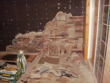

Here is the stone I put on in my addition. Most against the garage wall inside the addition that was painted superior walls.
With the paint on the walls, I had to do the mesh. I tried scratch coating and re-wetting the dry scratch coating was a PITA.
So I only left about 6" or 8" of scratch around the already installed stone after knocking off for the day each time.
Then just wet the scratch coat when restarting the project and then wet skim coating and buttering the backs of the stones to set in place. Worked out very well for me.

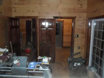

Here is my new office. MOst over the concrete garage wall with mesh, the smaller part over pressboard with tar paper & mesh.

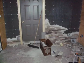

The new bedroom. Again over the garage wall with mesh and then I boxed out the back of the existing chimney with metal studs, then Durock, then mesh(yes I used mesh over the Durock anyway), then the stone in same manner as the rest.
