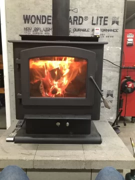

Here’s my Englander nc30, current model is nc32. I also own one of those “status symbol of wealth” stoves in my home. I have never regretted the 800$ Englander for a straight up heater with no frills.
There is bottom of the barrel junk from China, then there are the Englander/drolets, then a big price jump for no apparent reason to the name brand dealer only stoves.

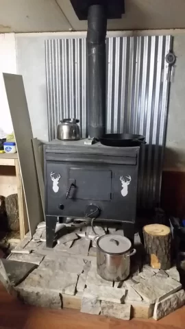

Welcome to Hearth. Drolet and Englander would be my first brand consideration's in that price range. Check each potential model of interest for mobile home compatibility. A few pics of your current setup might get some helpful opinions.
Here is a picture of my current setup.

Yes, that's true. It's quite a challenge to get heat all the way back to the bedrooms on each end. We positioned ours in probably the best, most centrally located spot in the house, and if we did have a more efficient stove that would radiate heat more efficiently, with a heat-actuated blower (maybe one blowing toward EACH end), I think it would be better than what we have currently. Maybe one day we can build a cabin that is more open and square.
